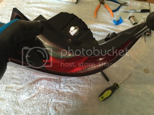

Next bake open. I did 215 for 12 mins. Then start peeling it apart CAREFULLY.

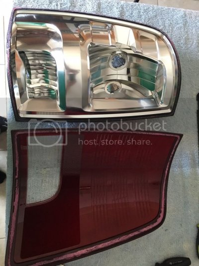

Tailight opened. I cleaned it out while it was open. I recommend gloves because you'll leave finger smudges all over the chrome area.

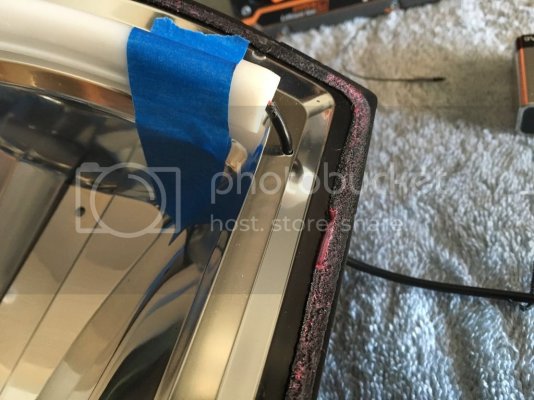

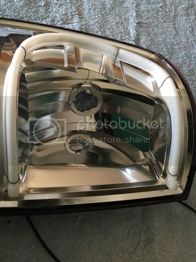

Test fit the tubes to see where you need to drill/silicone.

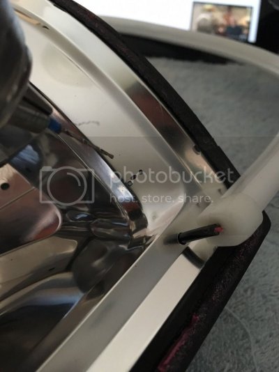

After you select your spot....drill a hole for the leads.
This was probably the hardest part. The tubes came with some cheap plastic holders and the worlds smallest screws known to man that kept stripping out. I wanted to insure they would not move...ever. So I drilled tiny holes and used 20gauge wire to hold them down. Finished wiring it down. With the lens cover on you can hardly see the wires through the VHT. Twist the wires on the back so they don't come loose. At this point I put silicone under the tube for double-tapping purposes. Them ***** arent goin anywhere.

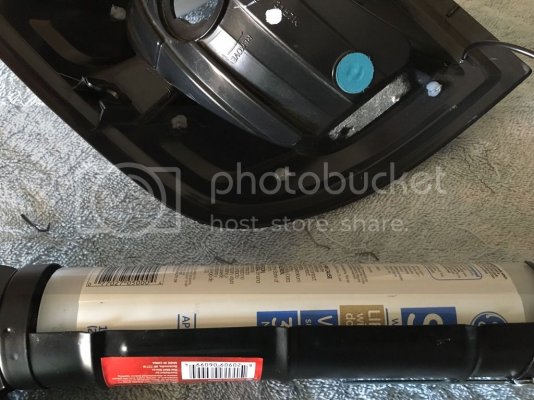

Next, flipped over and put silicone on leads and wires for sealing purposes. I let it dry at least 30 mins before continuing.

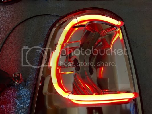

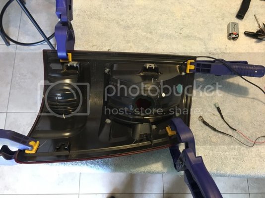

Next, test that sum_itch.

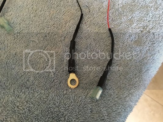

Power and ground....this can be done multiple different ways. This is how I did it. I'm a fan of the heat shrink. Also, with a quick connect if the tube starts acting up it can be quickly disconnected.
Finally seal it up. Use some clamps and let it set 24hrs to get a good solid seal.

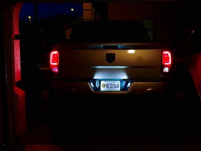

From here....reinstall on the truck and power it up as you like. There's so many ways I won't go into that.

Awesome work! Did you say these could be cut to fit different applications? What did you use to seal it back together?

They can be cut. I didn't cut them though. They don't recommend it. I had a tube of silicone in my garage I used to seal it back.

You think some thin white zip ties would work better than the wire?
I need to get some pare tails to play wtih.
I was thinking fishing line...

As far as fishing line or zip ties go... I like the wire he used best. Zip ties dry out and crack in high heat and fishing line might just stretch. Jmho
Sent from my SM-N910T using Tapatalk
Not just that, the zip ties might block too much light and be obvious with the lights on

I did consider zipties but I didn't have any small enough at the time that i would've used. Bird dog raises a good point about them breaking...it gets hot as hell here. Plus the wires are super thin that you can't really see them once there in there. I'd have to point them out to people who didn't know.

You can't see the wire in th pics. I was just thinking that to myself until someone brought up zip ties. All valid arguments against using them.
Do you know how many zip ties I have under my hood? haha.
I don't recall any one of them breaking.
I thought about the zip ties blocking the light, but I was thinking I have some frosted ones that are very small.

I know exactly the kind your talking about. They would probably glow with the tube and allow enough light through to be imperceptible if they are small/thin enough.
For no redo, metal wire is probably the way to go, but there are plenty of fasteners that could work.
