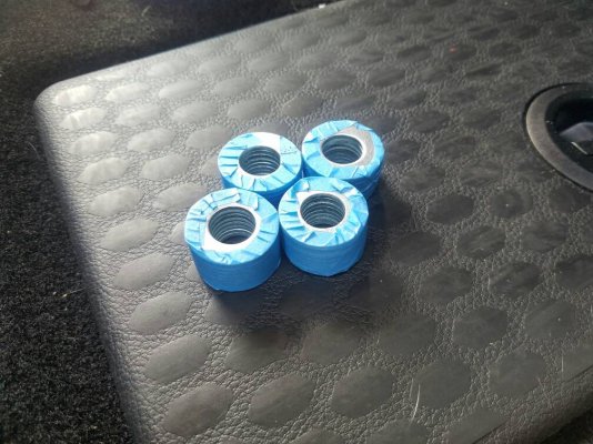

I wanted to fold my rear seats down for an amp mounting in the back and I found all the info I needed across several forums so I figured I'd put it all in one place with pics. Also, this doesn't require you order anything, just make a trip to Home Depot
What I Used:
11 bags of 1/2" washer (pic below)
18mm Socket
Breaker Bar (optional)
1" Masking Tape

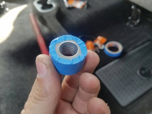

The articles say 1/2" of spacer but I found that 9/16" worked better for me, and that's 8 of these washers. I used the masking tape to hold them together instead of shoving them all in there individually.. worked much better.

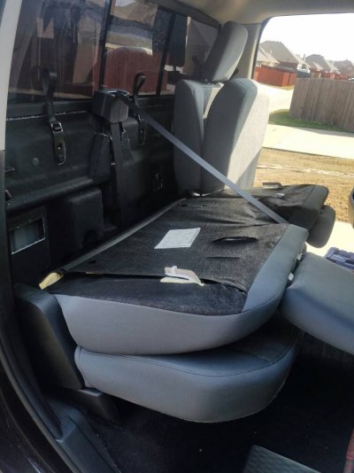

There are 4 18mm bolts holding each seat in, unbolt them. You may need the breaker bar to save some effort(work smarter, not harder) because some of those bolts were torqued with Zeus's Hammer for me. One in the front and one in the rear from each side.
No need to lift the seat up to check just yet otherwise it might be tricky to place back on, I promise if you removed those 4 bolts, you're good. Insert the washer blocks under each hole and hand tighten the bolts back on just so they're threaded in.
Once they're all threaded, tighten them all with the socket. I didn't use the breaker bar because I assumed they didn't need to hold a suspension bridge together, just the seats in place. I still used a good amount of elbow grease though. Once they're all tightened, lift up the seat and almost towards the top, you can pull the seat forward and it all folds down.
You might have to give it a decent tug or push to get it off or put it back on, like slamming a front seat in place when you fold it forward. You could always use another washer on each side, but this way it stays in place. Any questions, let me know!

Could I recommend to maybe suggest using 8- 3/4" nuts as an alternative to the washers? It works the same and less work necessary as you won't need to tape them together.

At first my idea was to use an oversized nut but I didn't know off the top of my head how much space around the bolt hole I had so I was trying to minimize the excess spacer around the hole but those would work just as well I bet.

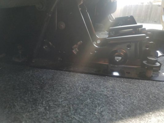

If you look at the pictures of the original post, when the seat is folded forward you can see the hooks that lock on to the rear wall that keep the seat from folding. I took a large crescent wrench, adjusted it so it fit tight on the hooks and bent them to the side, problem solved. The seat folds and it's not elevated by spacers. I've never had a problem of it folding on its own.

So with it in the normal upright position, how much of the hook is inside the loop?
I ask because I got about 9/16" with like 5 washers, not 8. I used some expensive green loctite my neighbor gave me, that basically forever glued them together. When I bolted it all back together, when I try to pull the seat, watching when it's at the highest point when you lift the bottom up a little, nothing happens. It's still very much hooked in, but it feels like there's a good 1" almost of hook. Granted I can't really measure and that length is probably off, but it's still enough that I can't pull it forward.

Depends.
I have to find a "sweet" spot between lifting the bottom seat and pulling the back forward for mine to unlatch.
On one hand, you want enough hook left to safely hold the seat locked in. On the other, it needs to be just enough hook for it to come unlatched when you want to fold it down.

Agreed, I'm over 3/4" in spacers and still can't get it to unlatch. I'm going to remove the spacers and forget about it.

I believe some guys file/cut down the hook to make it easier.

What RZRman said...I know I can make it work, I just don't have a reason to like you do.
I honestly think there was a change in length for the rear seat "hooks" sometime that accounts for the variation in spacer height. The best solution would likely be to add a little spacer height and file down the length of the hooks until it meets in the middle with minimal modification to each...

That's what I was just thinking.. since I can reach behind there and such, using a marker or whatever to mark where it is at both points... so I can cut and adapt it at that point.

If you want to look at why, unbolt your seat and lift it up, you'll see the hooks that we're talking about. It's what keeps it in.
