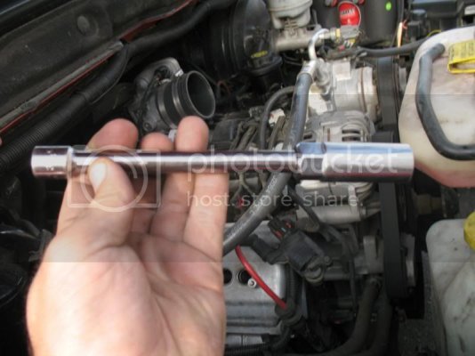

OK guys, here it is. A DIY on how to change the spark plugs in your 3rd Gen Hemi Ram.
What you will need:
16 New Spark Plugs (preferably copper)
Basic Ratchet set
A few different sized extensions
Spark Plug Socket
Anti Seize

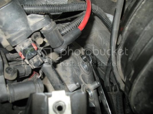

I like to start on the passenger side plugs first, because they are easier. Locate your first coil on the passenger side, and remove the 2 bolts holding it in place with a 10mm socket.
then simply pull out the coil and also the plug boot for the plug next to it. (note, i have shorty wires, so mine might look different than yours, the process is still the same though)

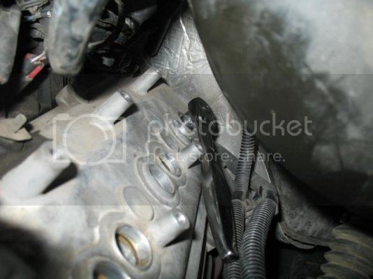

Now for the last 2 pairs of plugs, the dreaded 4 under the brake booster. OH NO! Actually, its no big deal. Just take off both coils, and the coil next to them. Be sure to keep them in order and dont mix those 3 up. Then just slip your tools one piece at a time into the spark plug hole. Socket first, then a medium length extension, then your ratchet. Loosen the plug, remove the ratchet, pull up until you can get a finger on the socket, remove the extension, then pull the socket with plug attached out of the hole. No big deal.
In the above pictures, you can see that I have a full sized 3/8" ratchet under the brake booster. I have plenty of room to work, and to turn the ratchet. Those last 4 plugs may look like a daunting task, but as long as you put one piece in at a time, its a piece of cake.
