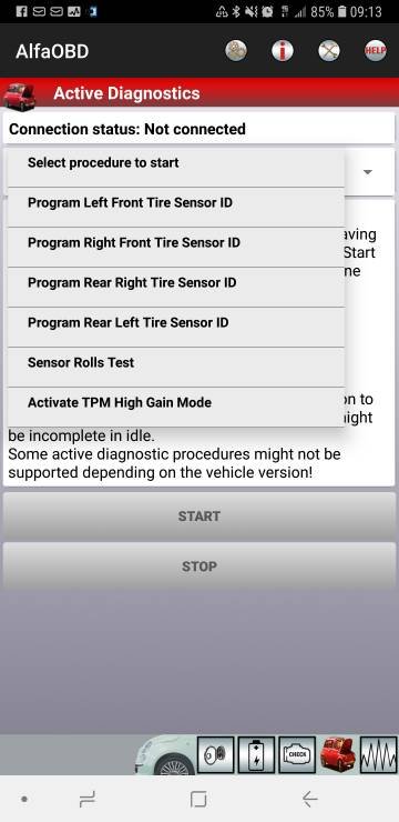

Has anybody messed with programming the tire pressure id's? I sold my set of rims and need to program new sensors and was wondering if this would work9a9011cf330902dccb8c0445f8a884df.jpg
Sent from my SM-N950U using Tapatalk
I don’t believe so. If you do, please take notes and perhaps even a write up in the DIY section.
