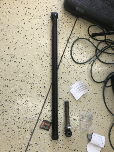

Got the Bwoody rear trackbar installed. It didn't come with instructions and i didn't know if there was a recommendation where to place the side with the jam nut, so i put the jam nut side towards the axel. I did send bwoody an email to double check just in case but i'm still waiting for their reply.
Took the entire join out and coated the theads wit anti-seize

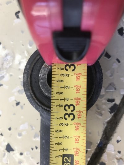

Measured the stocker at 33 11/16
40714729003_b99598e24a_h.jpgUntitled by RAM RSM, on Flickr

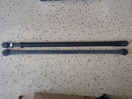

The Bwoody is thicker, hard to tell if it's solid or not but the stocker is definetely hollow and if you grab it in the middle with your hands you can feel/see how it twist, kind of crazy to think it's so whimpy considering these are trucks with a 10k lbs towing rating. The new one is a lot more solid and you can't flex that ***** like you can with the stocker.

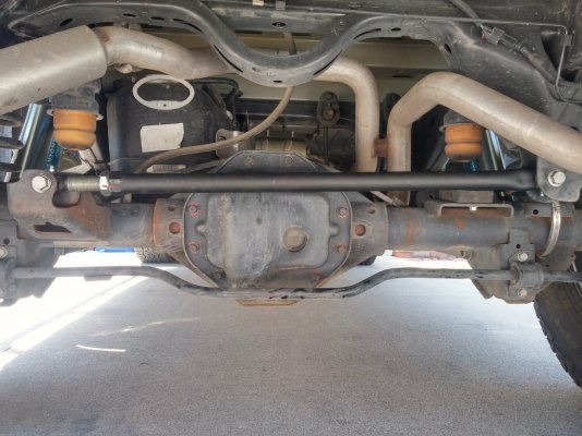

Final product

Forgot to add Bwoody got back to me and it this case it doesn't matter which side you pick to place the trackbar so i'll leave the jam nut side facing the axel.

Good to see there aren’t any clearance issues with the BWoody track bar, makes me wonder if Core4x4 track bar needs the optional bend.
i haven’t measured but it looks like 1.5-2” clearance by the naked eye. I’ll see if I can take some measurements today to make sure but it definitely clears without any issues.
