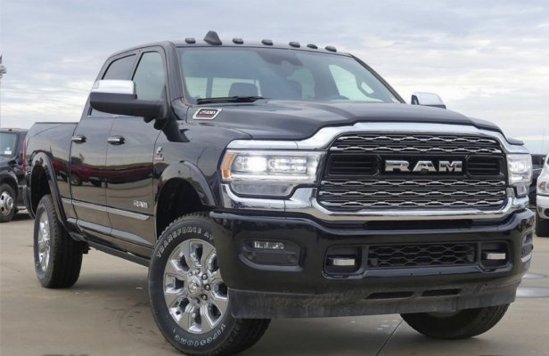

The easiest way to get the correct part numbers for the type of fogs/bezels/brackets that you want is to search autotrader, and find a 2019 HD ram that has the fog lights you want. Copy the VIN of that truck, and PM Benny at allmoparparts, and he will tell you exactly what you need. His user name here is AllMoparParts.com.
Jimmy07
Feb 23, 2017
3,512
3,565

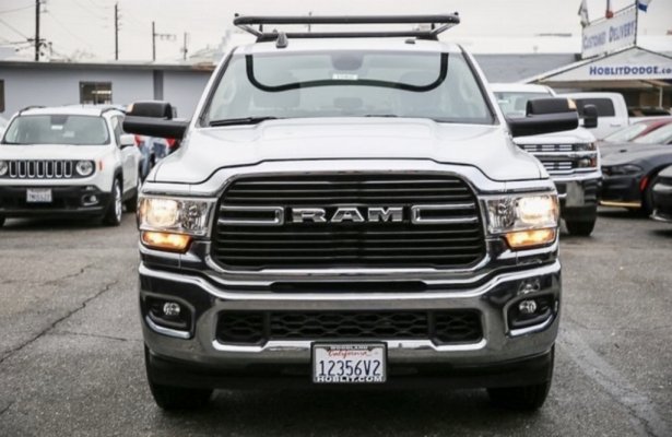

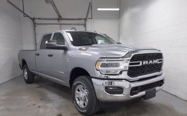

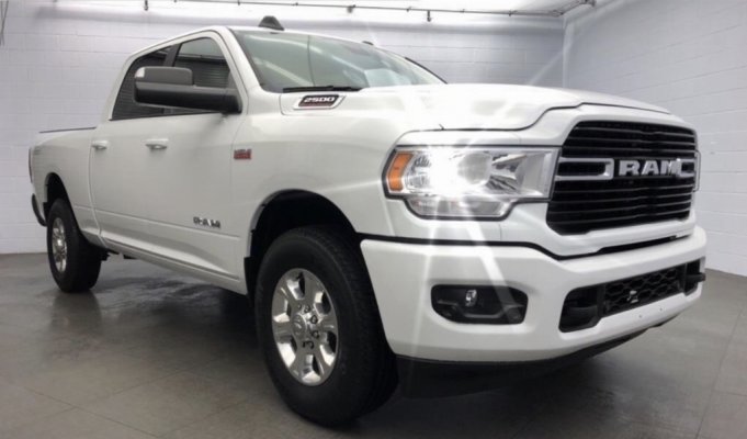

Dealer has several different part numbers for brackets, lights, bezels, but doesn't know which is which, WTF, I gave up, sent an email to FCA.
VIN of a truck with round halogen fogs. Bezels without park sense- 3C6UR4DJ5KG610614
Truck with round halogen fogs. Bezels with park sense holes- 3C6UR4DJ2KG680054
Truck with LED fogs. Bezels without park sense- 3C6UR5HL6KG595347 nh0I31P.jpg
Truck with LED fogs. Bezels with park sense holes- 3C6UR5SL8KG632889 CgtfS6J.jpg

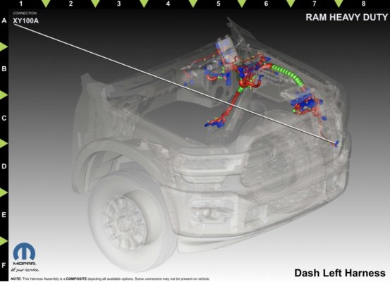

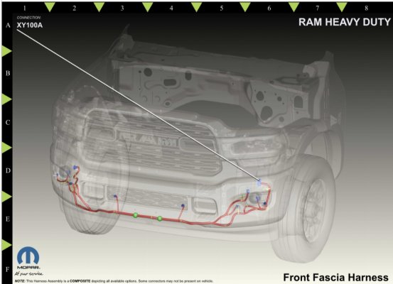

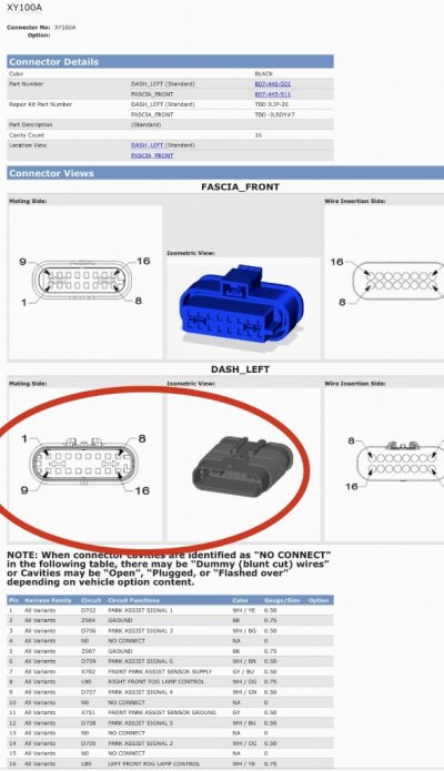

Before you buy the jumper harness, make sure the connector that it plugs into is present on your truck. Otherwise, you’re gonna have to make a custom harness, which will be cheaper than the jumper harness anyway.
This is the connector and it’s location you’re looking for- KZRM51I.jpgMHqcRLa.jpgZAm7mab.jpg
