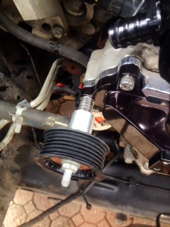

Started the install of these items yesterday. Using a pulley kit for the srt jeeps to route the belt around the pump. The jeeps accessories sit closer to the motor so I had to buy longer bolts and temporarily shim the pulley kit. Custom aluminum dive shaft is going in at the end of the week as well....it's 40% lighter than our steel shaft. Trying to squeeze everything out of this truck that I can NA :flipthebird:

What meziere pump is that? Didn't know they make one for our trucks.
Is that the electronic steering from the 2013+??
How hard was that to install? Use a 2013+ belt?

Where did you source the aluminum driveshaft and how much was it if you don't mind me asking? I'm still trying to get rid of parasitic losses as well.

Are the electric water pumps safe for daily driving? I was under the impression that they were for track use only. Great mods and looking forward to some track times.
I got it made from a local place...Advance Driveline. Cost me around $350
Only one way to find out lol! Should be fine....I know several people that run them on the street with no issues. You just have to be aware so that if the fuse does blow or the motor goes out on the pump, you catch it before the truck heats up enough to do damage.
