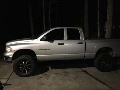

man, thanks for the great replies, gents. Good news, after a couple weeks and a lot of learning i have my lift installed. Glad i did it myself, the knowledge is priceless. Also, while i was in there, i replaced upper control arms, lower ball joints wheel bearings and all pads and rotors. Here's a bad pic, i'll post a better before/after later this week. went with moto metal wheels and 325/60/20 Nitto terra grapplers, which is a little over 35" and a little more than 13" wide. No rubbing and no spacers needed. Pretty damn happy with it. 0.jpeg
