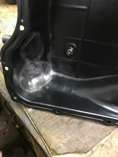

Has anyone changed the pan on an 03 with the RFE transmission? I bought a Dorman replacement pan but it won't fit, it hits the fluid filter on the front right corner. I saw on Summit racing's website a few reviews were left that it doesn't fit the 03's. anybody have this issue? Mine has a pin hole leak and it's rusting out. I don't want to spend $250+ for a deep pan...

Nice! Definitely beats dropping 300

Great work money saved for mods.
