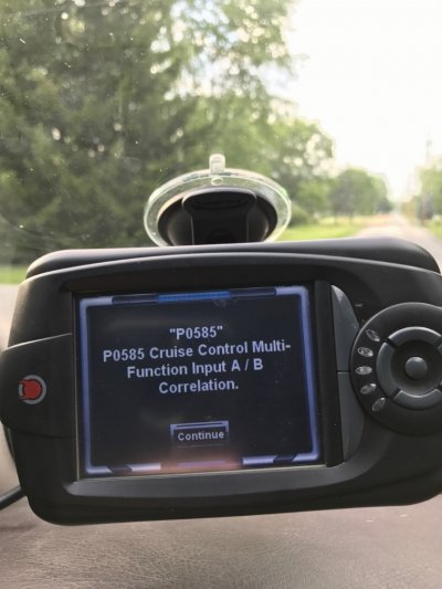

All I know is it worked perfectly before. After the swap I would occasionally get a few codes related to the cruise

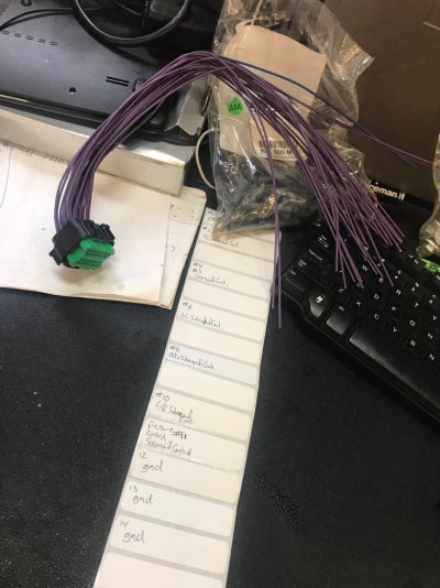

I switched a wire in the pcm we had discussed that seemed like a mismatch according to the pinouts, but that didn't fix anything, it now have about 3 cruise related cel's. so my next step is possible having a dealer vin flash me, or order another pcm and try it out. It's a process. Other then that and the tcm tuning issues I have, I love the swap. I was able to raise my idle for my cam and I think tuning wise it is overall better.
Hmm. I didn't have to change any pins. That's very weird.

My cruise doesnt work also. I had a nib pcm flashed for vin and accessories and thought they missed putting in the cruise. Since then ive spoke to a couple of others and their cruise also didint work. There is a wiring difference in the cruise circuit between the 03 and 05. It switches from a sensor ground to a cruise sense. Im working on it but its not a priority at the moment.

Me and Keith found the wire, and I changed it over last week. No change, it just added more cruise wire mismatch cel's. I changed c2 pin 27 to c3 pin 15. That's as far as I've looked into it

Yeh I think changing those wires wasn't the best idea, seems like when you change them you bet more codes. I'd put them all back to where they were

Keith, was the one who put me on to the difference. I changed the wires at the pcm. But now im going to go into the clock spring when i get a chance.

I really don't see any difference in the pin outs. I'm a dodge tech. I've gone over it and over it and I see no difference In the pin outs.
