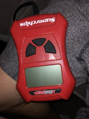

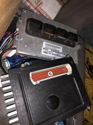

I dont know what they did. He said it would start and then die instantly when idling which is issue I had before the swap. We add issues with diablo bricking computer when swapping tunes. It would throw error and I had to send to diablo to reset pcm. I would like to get it to hot tod shop and have you guys explain to them what to look for. I have ported heads, comp 260 cam amongst many other addons. I also bought a 3815 superchips but it wouldnt load due to locked pcm. I just saw truck today so next time i have day off will try and get battery running to see what condition its in.

Where did you get your 05 pcm? You were having idle issues before the swap, any codes? It might be stalling out from running the comp 260 without tune adjustments

Got it all off ebay. Shipped to hotwireauto and they did the conversion. Thats why I tried diablo bc of the comp 260. Had someone send me custom tune. Still stalled. I will have to get it started up to see what codes its throwing
