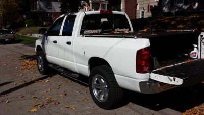

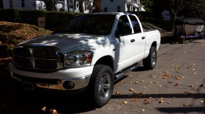

couple more

My buddy did it for me $200. Said it took about 6 hours and he mounted the tires too. The level kit was $50 off eBay. If you plan on doing this I would highly recommend spraying with PBlaster 3-4 times a day for about a week before you try to do this. I'm going to put a 1/8 inch spacer in the front. The tire comes real close to that upper control arm just for a little piece of mind.
Sent from my SCH-I545 using Tapatalk now Free
