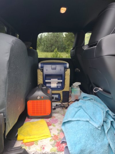

I run an ARB 50 and I would not recommend using the AC 120V inverter to run your fridge unless you are actually driving or you will have a dead battery in a short time. My ARB 50 runs on 12V for a long time without running the battery down but on 120 it will suck juice pretty fast. I use a jackery 1000 to run my fridge on 12V and it will run my fridge for 4 days without a charge and I I charge my jackery with either 12V or 120V while driving and it will usually keep the jackery pretty topped off unless of course I am not driving much but when traveling it works great.IMG_20220629_102456184_HDR.jpg
