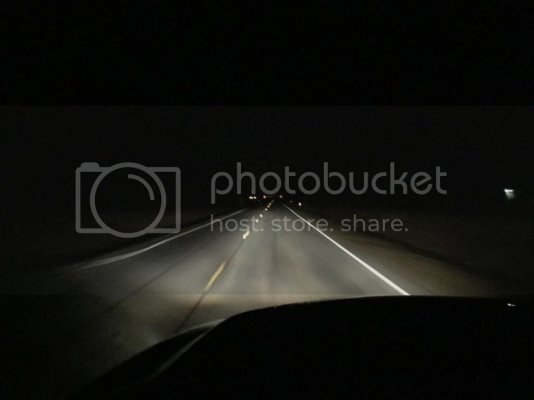

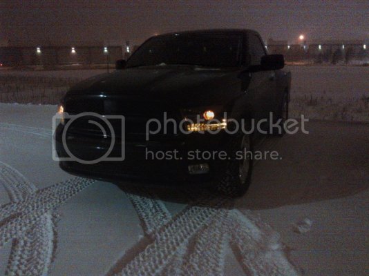

I used 90mm on mine. They unfortunately don't seem to be holding up so well though. One of them has already lost about a third of the LED's. Not sure if it's the cold or having them run constant when the HID's are on? I've heard they can be kinda sensitive to both extremes.
Mine are the previous gen Morimoto's though so maybe the current production are a less sensitive?
