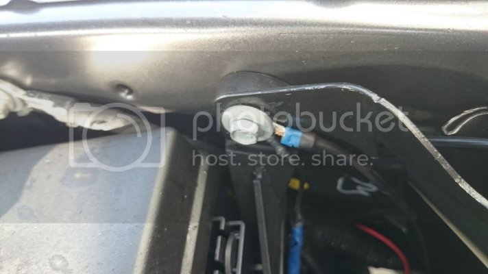

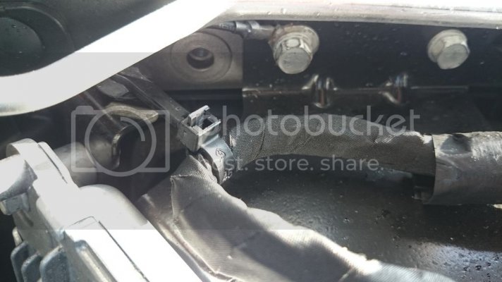

So I was a little off on my description. Maybe it's just a difference between a gasser and a diesel. Both locations are grounding locations in the engine bay right by the headlights.
Driverside
Passenger side

1500ram12
Jan 23, 2012
5,487
2,432
2005
5.9L Cummins
And some farther back
Driverside
Passenger side
Sent from my D6708 using Tapatalk
