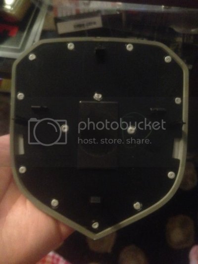

So where the green dots/glue are on the backside, if I undid those, the silver rings would still be blocked by the black bezel? I took off one dot and the silver ring seemed to move a little more.
I've also contemplated taking a rotary saw close to the plexi glass, and gluing all back together after
BlkXpress
Jan 27, 2014
661
316
DFW, Texas
I've gotten that far... but if you take a look at the back there are green dots that seem to hold the silver rings in place. If you pick those off, which is what I had to do for my emblem, I think the rings will come off. At that point I might be able to squeeze them through the inner square, and paint those. I won't be able to paint the whole black bezel, but at least can get the rings ( I hope).
I'll mess with it tonight and let you know if I'm right or wrong. Since the whole top piece if only $40 I might still end up taking a rotary saw to it for ***** and giggles.... But who knows. I've got to reassemble my girlfriends acura tonight so will see what I can accomplish on this.
I'm hoping the dots on the back have the same function as these- Which is holding it together

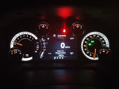

Just did my cluster tonight. Had to drive around aimlessly to get the last few miles but it is sick! Looks awesome at night. The only problem is now my u connect 5.0 really looks like crap lol
BlkXpress
Jan 27, 2014
661
316
DFW, Texas
Glad that worked out for you man. Told you it was gorgeous. Lol

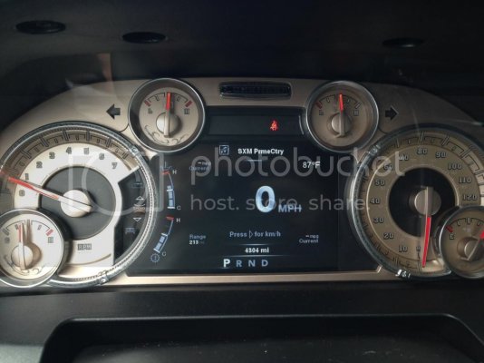

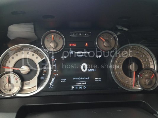

I swapped out the longhorn front half in favor of the black sport one. Still got gold gauges though.
Before:
Add this:
Now I got this:
