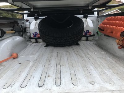

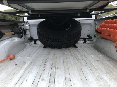

Definitely optimized the bed space. Still A TON of room for things, albeit they fit under the tent. I like the ball thrower for the dog is a primary piece of gear as well.
Mounts look awesome. Did you use backing plates under the feet of the spare mount?
Sent from my SM-N920V using Tapatalk
Yes the ball thrower is a crucial piece of gear to have in the rig. Now that I think bout it a special mount for it and a canister of balls may be in order!
I did not, as I was bolting it up it crossed my mind but decided not to do anything. May just put fender washers under there eventually.
Now you're talking! Maybe you can rig up a clay bird thrower to launch tennis balls?! That's the move!
It should be alright for the time being but depending how far into party mode you get that spare might try to ejecto seat, I'm disappointed at how thin the material is on these new trucks. Only way to know is let it rip. Not trying to create an issue that doesn't exist yet. Lol
Lol, now that you put it that way I’ll at least put the fender washers in there
Wording was a bit off in my post, when I say "let it rip" I mean boogy on it. Not that the bed will rip. God..... maybe my girl is correct, I need to proofread and filter before I speak. Lol. I'm sure you'll be fine, I have verbal spewage

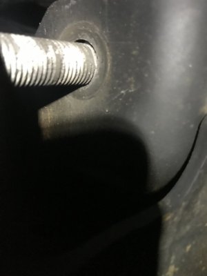

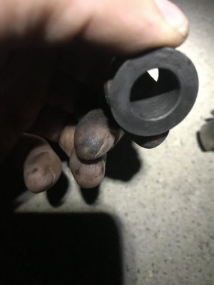

Heard a clunk coming from the rear end somewhere. When I shook the truck side to side it sounded like metal on metal slapping. Took awhile but found the culprit, trackbar. Heim on one end is toast and on the other end the misaligns amd mounting brackets got wallowed out from using the oem hardware and not buying shanked bolts. Ordered new misaligns, heims (this time Kevlar reinforced) and shanked 5/8 grade 8 hardware.

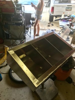

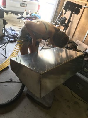

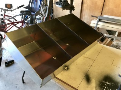

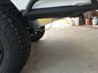

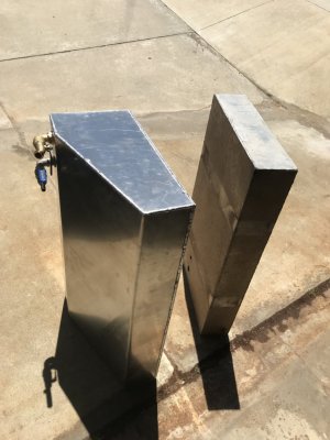

Finished water tank version 3.0 this time made the tank to accommodate 24 gallons. It is a bit more noticeable than the old tank but the ability to carry almost 10 more gallons is worth the trade off.

Any pictures on how you mounted up the water tank? That’s where I’m looking to have a fuel cell made to go if I ever get around to it
