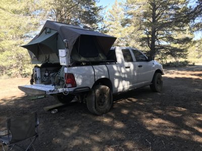

Kennedy Meadows and Kern River. Happy to say that the Clayton coils performed very well even with a full water tank and all camping gear. At no point did they fell to stiff or have restriction on the compression cycle. Looking forward to more testing. At this point doesn’t seem like I need to change the valving on the rear shocks. Oh and picked up a few more pin stripes.
Very nice to hear Zach. I still can't shake the grin of my face when i load my stuff to the roof, and i'm sure you have a few lbs more weight than me because of you camping gear, these damn Clayton springs were a blessing during the Covid chit, not only they're long but they can hold the weight very well..., and to think there is even another version (3.5's) if it was needed lol.

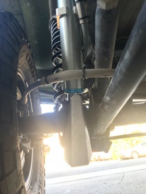

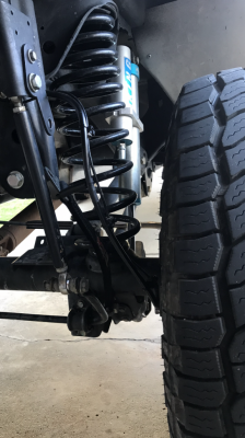

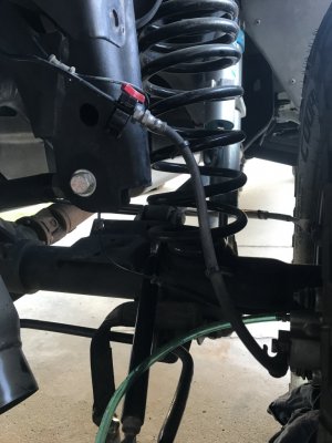

Front +3 and rear +5 KLM brake lines installed. Should have only done +1 or 2 in the front. Rear I was aiming to get 3” longer but knowing had to cut and re flare the line went with the +5 to account for any tube loss or mistakes.
Longer rear lines made it possible to get some more droop out of the Kings.
Hub to Fender measurements
Straight Bump- 19.5”
Ride Height-25.25”
Strapped at - 31” (shock eye to eye 28.5”)

11.5" of vertical wheel travel is impressive for oem stuff on what's supposed to be a street truck. Especially with basic bolt ons. Articulation has gotta be even more impressive! I forgot to cycle the front end with my coilover out to see what the actual travel is, but I keep reading between 9 and 10" which, paired with that rear setup you're running should feel pretty nice offroad for sure.
After dealing with flaring nightmares on my xj I don't think I'll be doin lines any time soon, it's much easier to just run a little shorter shock lol.

Awesome bro i was going to ask you about the length for the rear, so 5" is what i should ask for the rear correct ?

I ordered 3” front brake lines and wish I had only ordered 2” lines but they fit. I ordered 3” rear lines as well and they fit perfect for me with cutting back some of the hard line. I have slack still when I lift my rear tires off the ground. Yours Looks good. I think I’ve measured out roughly 3.5” of down travel still in my front with the bilstein and eibach combo on top of the 1/2” puck spacer. I’m guessing 9-10” of front travel. My rear being 1” taller and the extended bilstein shocks I’m not sure. I’ve yet to test out the rear flex. These shocks have 10” of travel though. I need to get off-road but the group I’ve been trying to go with has canceled all their events due to Covid.

4-5” is a safe bet for the rear. I lost about 2” on the passenger side trying to get the double flare correct. Lost about 1.5” on the driver side to get a straight enough section. All in all I probably ended up being 3-3.5” over oem. Had to do a zip tie and standoff to pull the line in, was awfully close to the tire at ride height. Oh and the new male fitting will not slip over the coating on the tube, you’ll have to remove that before hand.

Same here, first I forced the fitting up far enough to get the flaring tool on there but it kept slipping, so cut that section off and took the trusty angle grinder with a wire wheel to it while brake fluid was dripping out of the line. Was covered head to toe in fluid, a **** show that to say the least lol. Then used too much pressure and cracked the flare. Cut it off and finally made it happen. Other side went pretty smooth.

They are just plain steel with a plastic like corrosion coating.
I’m used to doing the compression style with a ferrule on seal lines at work, which is a breeze, so thought a double flare wouldn’t be that bad. Man was I in for a surprise lol. Couldn’t imagine having to do ss lines with one of those hand flaring tools.

SS will either be brought to the shop or get compression fittings next time. No joke. I actually smashed one of my flaring tools on day 2 after failed attempt like 9. Never ever again, id rather punch a cactus with my face.
