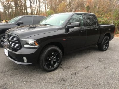

You have projectors or quads? and BlownGP is right on with the Opt7 but it will depend on the assemblies you have currently.

Sport
I have a 2016 Sport
