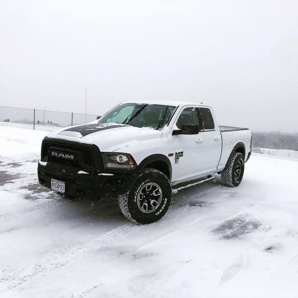

I did 2.5” in from & 1” in rear. Sits level and I’m happy with it.
Which leveling kit did you use? Looks awesome. I just bought a 2021 Ram 1500 Warlock. Can't seem to find too many leveling kits for classic body style. I'm planning on keeping my stock 20x9 wheels and possibly go with 295x65xR20. Not sure if that will work.

Bilstein's in the front set to 2.8. Sits about 1in high in the rear unloaded. With the warlock factory lift you'll only see 2in of lift with the bils. The Factory lift is only about .7"
Mines a Quad just like yours. Except it's a 2021 Warlock. I'm wondering if that same Bilstein will work in mine. All, I want to do is just level the truck in the front. I'll end up putting little bigger tires on the stock 20x9 rims, maybe 295x65 or 285x65. Which Bilstein did you put in your truck, do you have a part #?

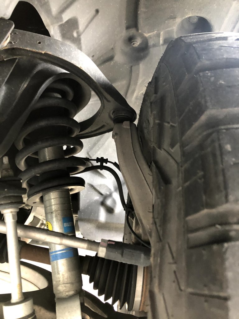

Ive got the bils at 2.8 on my quad cab. with the bed completely empty she sits an inch bed high. With my tri-fold cover and around 100lbs of assorted tools and such, she sits level.
This is the Part # for the Bils: - Bilstein 24-187367 5100 Series
295/60R20, 295/65R20, 285/65R20 would all fit no problem. Most likely you could also do 35x12.5R20 on the stock wheels and you wouldn't rub. I know the KO2's run a bit small and fit. The Dealership I bought mine from does the bils at 2.8 with the 35x12.5R20 KO2's with some of their warlocks sitting on the lot.
Here is mine with 35x12.5R17 on rebel 17X8 rims. These have the same backspacing as the 20x8 rims that come stock on the warlock.
You can see how close it is though. However no rubbing.
Here are 315/70R17 Grabbers on with 1.25in hubcentric wheel Spacers
I say go for the bils! if you ever want to go higher you can, and you can re-use them in the lift.
