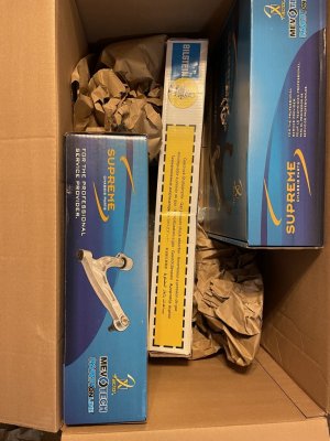

Yes it is a 2019 warlock, 4x4 build sheet said it was already “lifted” an inch. I ended up ordering a kit with Mevotech UCAs and the bilstein 5100s. But the Mevotechs don’t look much different than the stock UCAs. Hoping to slap it on soon. Hope I bought the right stuff! You’re saying that if I put the bilstein at 2.8 I should sit level? Or would I be better off putting at 2.1 to still have a slight rake forward? Since I’m sitting exactly 2 inch difference from front to rear?

Good! the mevotechs are the same as stocks, just much beefier and a better ball joint, so not a bad buy. Something like zone or icon UCA's will correct the angle. I'll show some pics as comparison later. I would 100% go 2.8. I have around 1" of rake even at 2.8, as do most with the warlocks. If you want even more rake you could take out the spare, as it's useless with larger tires anyway. Without my spare, bils at 2.8, and my hard trifold cover, I have 1.5" of rake.
