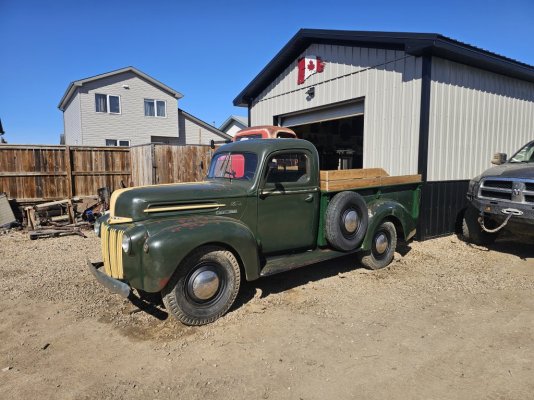

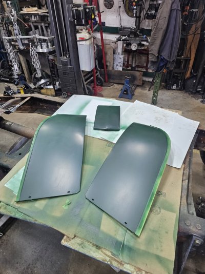

Getting all the stupid green spray paint off and the patina it was hiding is perfect. 1500 grit pad and linseed oil.
Visor center support and hubcap clips just cleared customs :peace:
This thing will be an awesome summer cruiser.

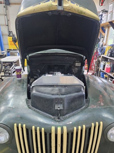

Well the 80y old rad decided to **** itself.
So new triple core Aluminum Rad, inline block heater , and like all my vehicles good old fleet coolant.

Its in cold storage for winter. Wont be driving it. Just want it to be plugged in so when it hits below -20 it will kick in the smart plug.
Will do a 60/40 mix on antifreeze as well.

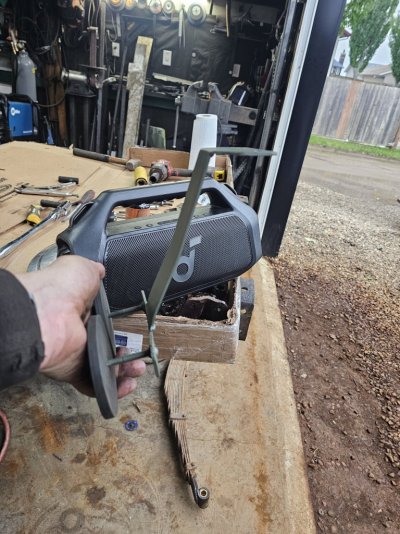

Finally got some tunes. Made a simple magnetic bracket. Ran a USB cable to the glovebox so I can recharge it with a battery bank.

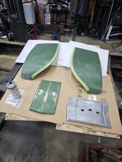

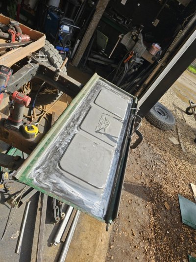

Was able to finish it this morning, Might as well put in some finishing practice before the cab. Got my metal to metal applied. I'm hoping to have it primed after supper.
