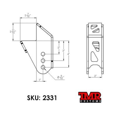

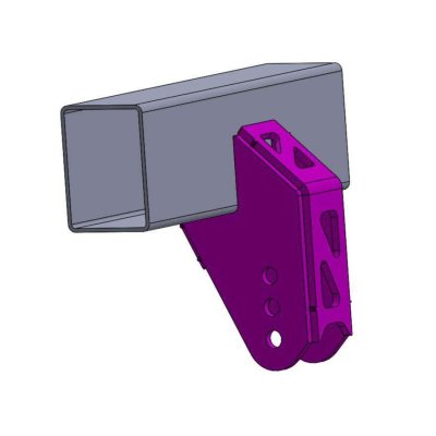

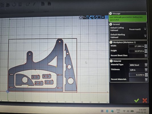

I think I will copy this design for my frame side track bar bracket today :Big Laugh:
Also will need to modify the one thats on the Dana60
Havent used the plasma table in like 6 weeks. Thats some bullsh!t I need to rectify...lol...
TMR customs is awesome, its acutally only 76$ Cdn for that piece. Not even worth building it at that price. But Like everything else on my build, it wouldn't fit without any modification on my truck.:rolleyes:
And I also found a decently priced Gen 3 Dodge NP271 T-case shift lever on eBay this morning, The ford one was engineered by ******* morons.

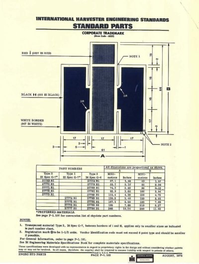

Cant belive I found this, Time to make it in CAD and get it ready to cut on the plasma table.

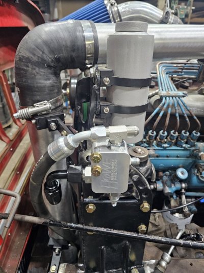

Designed a simple Power Steering cooler bracket :cool: , My Howe Performance bypass also shipped yesterday :favorites37:

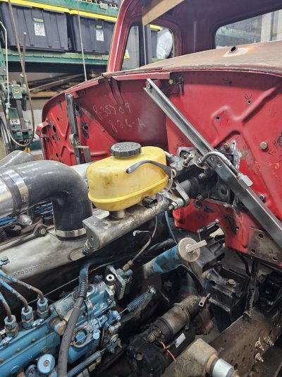

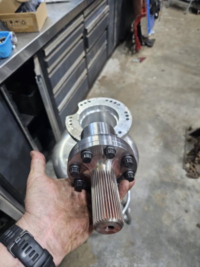

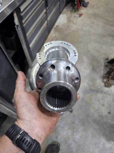

Today was a good day.
F550 hydrobost installed. Ordered a bunch of fittings and hose to hook everything up.

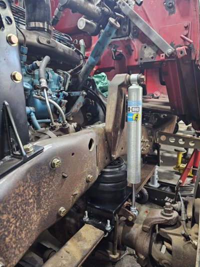

Shock is pretty close to the bag, I'll cut some 1/4 spacers on the plasma to move out the mounting bracket. Will also cut top protectors for the bags. As the included ones are absolute dog **** that just collect garbage and rust out.
I did install some Air lift cradles as well. To make up the difference so the internal bump stops hit.
The T-Case adapter also showed up. :peace: :smoke2: :anitoof:

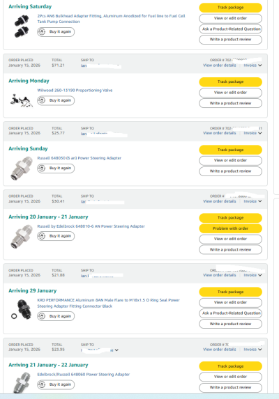

Dont worry the low pressure side will all be AN fittings ;) Those morons at Ford sure like making everything more complicated with all different thread pitch on the Hydroboost and PS box. Must be why they like to eat **** so much.
But I wanted some good hose in that area due to the fact that I cant secure it all properly. Will also wrap it with hydraulic hose protector. :cool:

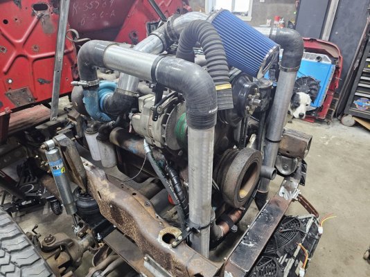

Waiting on my Amazon order so I put the bumper on and tested the bags :peace:
I'm putting on 40s so that bumper will be 4" off the ground at full drop. It's the price to pay to keep it 4x4 . But having a Dana60 high pinion up front is cooler ;)
