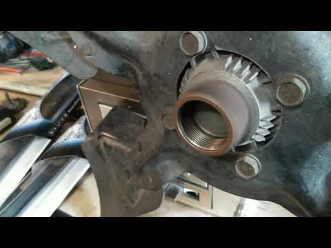

First, get yourself a set of R134 gauges. So much can be diagnosed from gauges. Also, My 99 had a similar problem where unless you were moving the a/c wasn't very good. Turns out that the old fan clutch was worn out. The truck never overheated, but you could never hear the fan in the mornings when first taking off. It never occurred to me it was weak until I put the new one on.
I put a short clip of the fan clutch I'm talking about on youtube.
