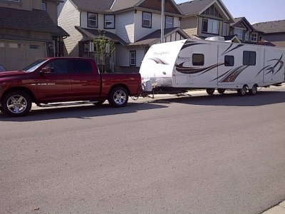

@Igolo- I'm also -2" in the rear and I pull a 32' TT all summer with 0 issues (thanks to Airlift; it couldn't be done without).
The ride is same as factory.

audio1der
Jul 30, 2012
5,300
1,105
Airdrie, Alberta
What's the tongue weight of what you plan to tow?
My Sport payload is about 1320lbs, my tongue weight of the trailer is 700 and we're within 100-200lbs of max after adding people & gear on factory 20" Crapyear tires. Just throwing this in for an apples to apples.
If you have Rambox, a low or highly optioned truck etc it could alter it enough to throw my experience out the window for ya.

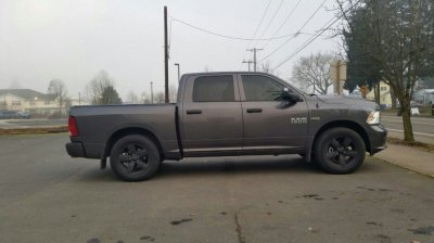

Don't plan on towing much but love the minor drop. It's such a minor mod but so many people notice it. Truck sits perfectly level. Just snapped this pic 2 minutes ago. Dirty truck, needs a bath.
