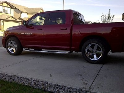

I cut the stock springs. It rides like stock, and I mostly use the truck to tow our 32' trailer.
I didn't change the rear shocks or panhard bar. Rides like stock:)

How much did you cut? Did it level the truck? Pics?
I'm not sure I have the leftover pieces anymore... Start with half a coil. It's ridiculously easy to remove the rear springs and you can always cut more.
On my first attempt, we cut so much it exactly leveled it, and I hated it (that was about -3" in the rear). When towing, it sat on the bumpstops.
Take 2 (new stock springs): cut half as much to begin with, -2" in the rear, still just a touch of rake left, tows like stock, looks great. Here's how she sits (out driveway has some incline to it)

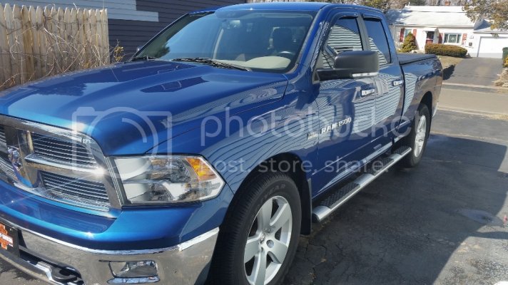

I cut my springs.I bought a set of stock springs someone on the forum took off their ram so I didn't have to cut my stock springs in case I didn't like it. I cut 1.5 coils and it now sits just slightly higher in the back instead of the 3+ it was sitting before. No changes as far as ride quality or none that i can notice any way and I only tow on occasion but I haven't since I cut them. I also bought a set of bags in case I need to install them if it sags when I do tow. The rear springs are easy to remove whether you're cutting or replacing them. The whole job only took me about 45 mins to remove, cut and reinstall
Rlaf75
Nov 13, 2015
1,804
2,364
East Hartford CT
2021 Bighorn
Not the best picture but it's the only one I have of it since I cut the springs. Maybe it will give you an idea anyway 20160309_125623_zpsoydbmdjr.jpg"]20160309_125623_zpsoydbmdjr.jpg[/URL]
