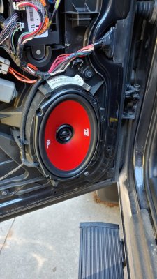

I just threw these MTX 2 way's in today (front door). Now these are not $200 speakers but I did not notice a huge difference in sound. There was a slight difference but it wasn't earth shattering by any means. I'm going to say don't expect much of anything from just adding speakers without an amp. Anything aftermarket is really going to need more power to drive them period.
