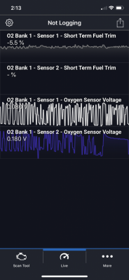

Hey everyone I've got a 2000 Dodge Ram with the 3.9 v6 and I've noticed a lot of rough idling for awhile, I get heavy vibrations while driving sporadically, plus vibrations when rpm increases while parked. I bought a scanner just too see what was going on. and I've got voltage meters for both oxygen sensors but only the fuel trim for the first sensor. Heres the graphupload_2020-2-3_15-21-55.png

Well, you are not going to have a Short Term Fuel Trim for the 1/2 oxygen sensor. You need to look for the 1/2 Long Term Fuel Trim.
Once you see what the LTFT is doing on the Downstream oxygen sensor it will aid in diagnostics. Your short term fuel trim is not terrible in the pic you posted. The PCM is pulling a little bit of fuel at idle bit not much.

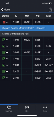

but I checked in another section called mode 6 and saw this:
but went and checked my smog test section and says my o2 sensors are fine as well as the catalytic converter is fine as well. any thoughts on what could potentially be my problem?

I use a widely used scanner app for my truck and my O2 sensor also fails the 11:01 test. The truck runs fine though.

Also, have you replaced your O2 sensors recently? If so, what brand did you use? These trucks are apparently sensitive to sensor brands. I'm running NTK/Denso sensors in mine. I was chasing the 11:01 component failure as well. Even after new sensors, I still get that failure. There have been issues with people running Bosch O2 sensors.
