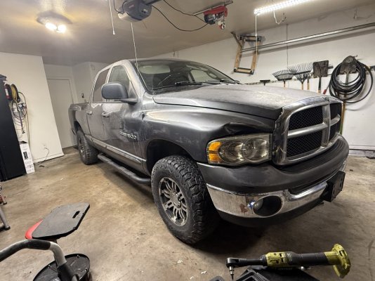

I bought an 03 ram 1500 4.7 4x4 with no engine, but i had everything for it except the short block. I bought a block, it had smooth bores no rust and the guy said he put new rings in it.
I put it together with new head gaskets and new head bolts. torqued the heads to spec. * the heads i had were from a different engine, appeared fine * put it in the truck and started it up .. sounded good, but gradually started smoking.. and i mean it was churning out the smoke. bluish smoke.
I did some research on causes.. and figured it could be the valve stem seals.. so i pulled the heads and changed those. put it back together, torqued everything and same deal.. smoking LMF.
I'm thinking maybe the cheap amazon head gaskets i bought are not right? or maybe a cracked head or block... i cleaned up each head and the block surface and saw no cracks... but still i wonder.
Next i plan to take the plugs out and do compression test on all cyls and maybe get a borescope camera i can peer into the cylinders with .. maybe see something?
Hoping someone here can offer some advice on if something different i should be trying?IMG_2481.jpg

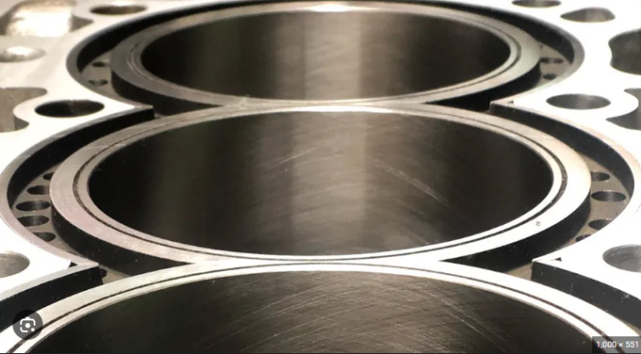

New rings should be installed in a freshly honed bore. What do you mean by "smooth" bore? Was it honed before the new rings were installed? with a visible freshly honed crosshatch finish? If a person claimed to have put new rings in but the bore is glazed smooth, i'd be very skeptical of the "new rings" claim and especially skeptical of the quality of that persons work.
