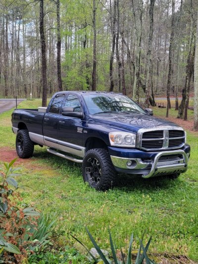

Thats what I was wondering myself. Here is a couple pics to see what I was talking about20220405_191408.jpg20220417_150349.jpg

First problem is those wheels have far more offset than they should. Those are only a 12.5" tire, so 1.75" wider on the front side and back side as the ones I am using, assuming you are using a rim with the same offset. They look to be sticking out a good 4-5" past the fender. The one picture looks like the rear tire has almost half its width out past the edge of the fender. The stock tires on that truck were a bit over 10" wide, no way 12.5 should hang out that far. Whoever sold you the rims didn't know what they were doing. Other problem with that much offset is it puts a ton more stress on the front bearings and the rest of the front end, as well as the rear bearings.
I would be going back to that tire and wheel shop and make them put the correct offset rim on your truck. I would also be looking for a rim that tucks those meats in as far as possible without touching anything at full left and right lock. I think that would solve about 95% of you problem.

Unfortunately I purchased the truck with these rims on it and bought new tires only. I will definitely look into the right offset rim for sure cause I don't care for the ones that are on it. Any particular place you think would know what I need without any extra issues

I am in Canada. I don't know rim and tire dealers State side but if you find a place that does a lot of off road rigging it would be a start. A few questions and u can pretty much tell if the guy is full of it or knows what he is talking about. Look up the offset and size of the stock wheels. Work from there even going with 20 inch rubber. You want to stay pretty close to original offset.

For your information, you do not have a mega cab. They never produced one with an 8’ bed (there are custom made ones out there, however).
Just do some minor trimming and those tires should fit. Or get some less offset wheels.
