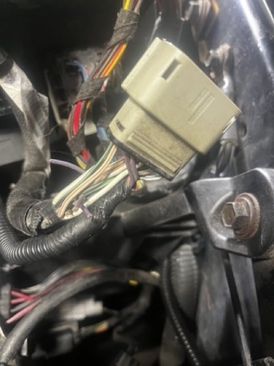

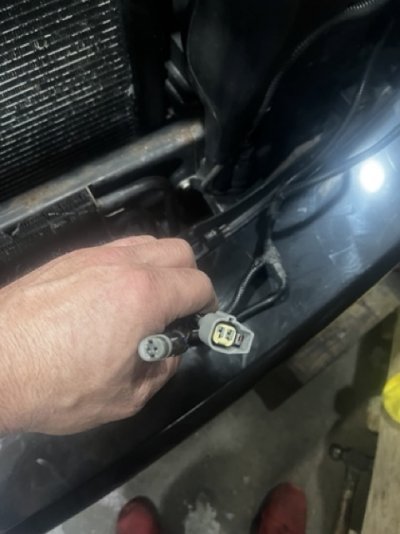

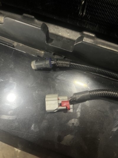

This is what i have found under the fuse box.Still not getting nothing fuel pump not turning on just a ckick unless i jump it through the fuse panel not sure if it is th=e right way to jump it but it works for me.Any ideas where these belong they are on drivers side they are hooked uonwith the wiper bottle and crash senor maybe this is the reason why?
Did you use the engine harness off the new engine or your old engine?

I used the harness off the old engine. Someone spliced those wires in. And i do not remember taking those off. I never have this problem before and have done hundreds of motors over the years.
