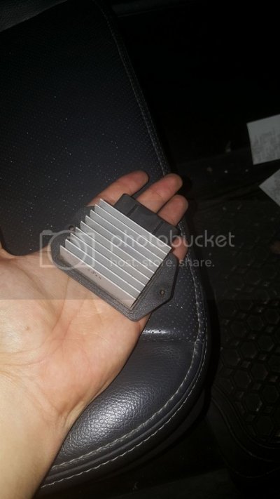

1. Dual zone A/C is acting weird... for example it has the recirculation bled door actuator problem and I know that I will have to take the entire dash apart but theres anothe issue, when I start the truck it takes a while for the fan speed knob to work... it starts at the lowest speed and no matter what speed you select it wont go faster for at least 5 to 10 min then it works normal... what could it be since the ac controls are a single module?

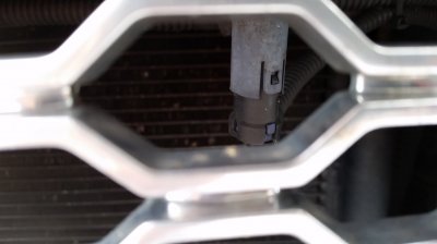

2. it was equipped with remote start but it seems to be missing the hood pin and wire harness cause I cant find it for the life of me and when I want to use it evic displays remote start aborted hood ajar... if some one has a picture of it or were its supposed to be would be great if not, would it be possible to use a 2010 hood latch sensor and adapt the harnes?

On issue 1, try replacing the blower motor resistor/module. When they go bad they can make the fan speed do all kinds of weird things.
I have a 2009 with remote start. I will photograph this part tonight for you.
Do you mean this thing in the photos? looks brand new... not even rust or dirt in it do yout think it could fail without looking damaged?

Yeah I think that's it. Yes they can be bad even if they look fine. My father has a Pathfinder with dual zone climate control and the fan was doing exactly what you're describing. Replaced the blower motor module and it's been fine for over a year now.
Sorry for my late response but its been cray weekend to try and fix it however I dont think its the blower motor resistor... while trying to bypass my pin switch for the remote start, thought it was best to disconect my battery... just in case I pulled a self-barbecue-style-grounding-movement... it took me like an hour to bypass the switch when I reconnected the battery to test the remote start system the hvac started working properly... every speed was available from the very first moment after starting the truck but afetr 3 cycles of on and off, the "issue" started all over again wich lead me to believe that its some sort of failsafe mode maybe? or maybe my hvac control module needs a reflash?? any way just in case some lost soul with a 2009 sees this thread and wonders how to bypass the remote start switch it took a 1k 2watt resistor with its prongs inside the male plug and that was it... and before someone flames me for it its just a temporary solution I allready ordered another switch and male plug from mopar but it takes another week to arrive

I got the same issue with my blower motor as you. As well as the passenger blend door. Just out of curiosity, did you have to take the whole dash off for the blower motor removal/replacement?
for the resistor on the picture? no its just the lower glove box and its facing the floor however I havent tried to take the hole blower motor... like I said if I disconnect the battery for half an hour and let the computer to reset its starts working fine so it is either a problem with the software or theres another issue... now that you mention your passenger blend door just like mine Im thinking it could be a failsafe mode... maybe with the bleend doors not working properly... have you tried disconnecting the battery yourself?

sorry it took me so long to get you these photos. you may have already found what you were looking for. here is the hood sensor switch on my 09 laramie. it is located just to the right of the latch mechanism in that round hole. on the hood itself there is about a 1" long plastic plunger that pushes on this switch.
I found the harness but not the pin location thank you it seems Im missing the bracket guess Ill have to order or fabric a new one but it does help to see where its supposed to be... it seems they stole that pin and bracket from the truck

If I found a solution to our problem you´ll be the first one to know...
Found the solution... Just had it fixed on my rig... It was just the passenger blend door motor. Nothing wrong with the blower motor. I got some pics in my thread as well.
