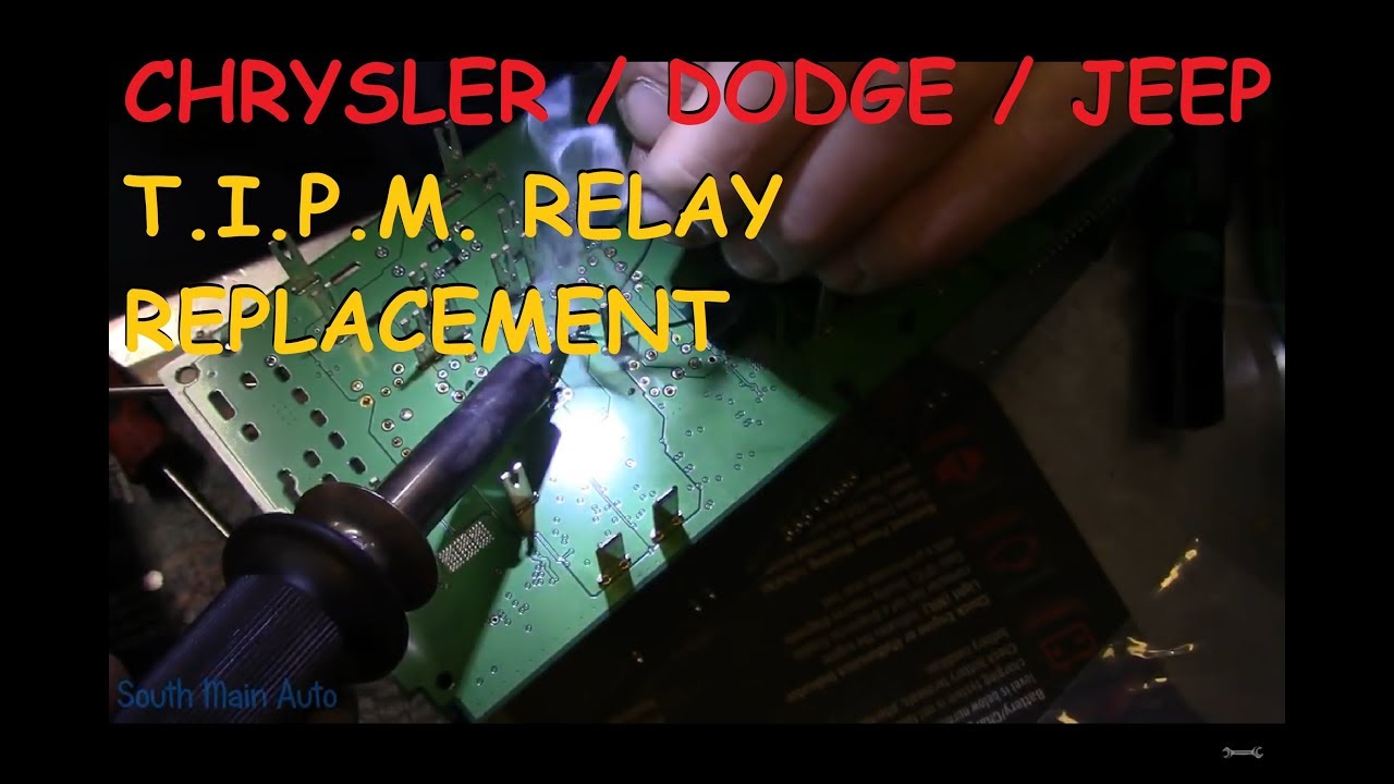

No you can't reset a bad solder joint, but with your experience you can see the youtubes where guys actually fix their TIPM's. This dude is like top 5 on a lot of us ram forum's guys DYI leaders. BTW, this was a wiper repair. This is also why I say for this most guys replace the TIPM< this one isnt for everyone.

LOL, I understand a cold solder joint is hardware & can't be reset. I've just read about trying a reset to potentially remedy erratic gremlin issues. I should have qualified that a bit more precisely. :cool:
So, what I should have asked is; Is the TIPM just a simple hardware interface between a wiring harness and fuse or relay sockets with zero brains?
Those that speak of resetting a simple hardware interface between a harness and sockets are likely dreaming.
Yes, I did watch a pro fix a TIPM on YouTube.
