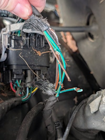

Final update: I ended up fixing it myself. Out of the main trunk, comes seven wires taped up. To go to the brake booster and the other five go to the windshield wiper. My street lost power well repairing it, so I used my power station to power the soldering iron and related to repair it. The proper tape to reroute the loom just came in, and I will be done and everything is back and running 100%. I plan on releasing a video soon, if it interests anyone.
Update: also turns out that the windshield wipers are not working properly. They will only work on low or high. The intermittent won't work and when you shut off the wipers, they will not sell park, they stay wherever under which you they were.

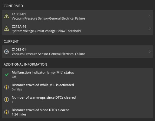

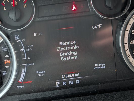

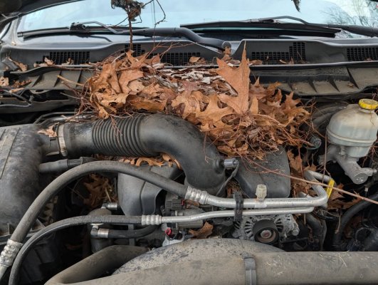

So, short story long. My low beam blew out and we had two feet of snow, so I drove my other vehicle. That was weeks ago. I went to start the truck this morning and the battery was dead. Strange since it was new. I lifted the hood to jump it to find the most largest nest in there. Branches leaves you name it. I cleared it out, put the trickle charger on it and left for work. Came home, it was all back. The squirrel freaked out and jumped out. I started the truck, and was greeted with a service electronic braking system. I cleared the codes just in case, but no good. I took a look around, and nothing obvious. I was hoping somebody could point me or even better yet, show me in a picture which harness it may be, so I could look to repair it. Thanks in advance.
