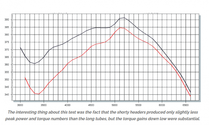

Believe it or not long tube headers can cost you power when you’re under 400hp. You need some back pressure. Back in the day everyone ran long tube headers and what they found out is better performance was obtained with shorty headers on lower hp motors. If your running power adders (blower, turbo or nitrous) then thats another story because the adders will push the lower hp motor over the threshold justifying the long tube. Diameter of the pipes matters as well.
Most if not all that is myth and has been debunked. take a look here. https://www.ramforum.com/threads/headers.196956/

From that article:
The interesting thing about this test was the fact that the shorty headers produced only slightly less peak power and torque numbers than the long tubes, but the torque gains down low were substantial.”
Yes the torque gains of the long tubes were substantial down low as proven by the graph.(shorties in red long in black) Not what you think being oposite.

It's not about restriction at all,never has been,it's all about pulses in the primaries creating a scavenging effect , to help pull in more intake flow. Even back in the 50's we knew about the scavenging effect created by the exhaust,check out what the RamChargers were doing in the 50's. By the later 70's it was common to run collector extensions to help promote scavenging,very few guys were running open headers with out collector extensions by then.
