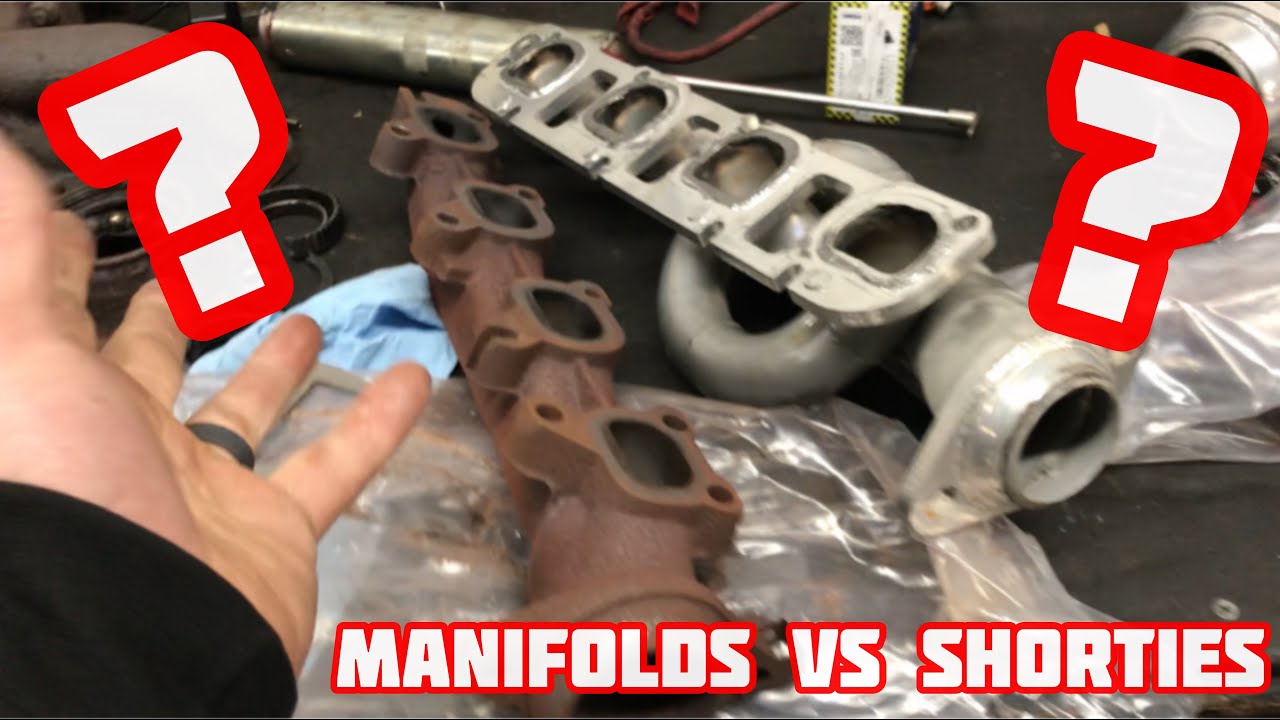

One test i've never seen done is comparing a ported set of stock manifolds against a set of shorties. I've always wondered how a set of extrude honed log manifolds that are port matched to the heads would stack up against a set of say JBA shorties or any other make of shorty header.
Might be a small niche market out there for a set of port matched/extrude honed stock manifolds,lol
with all of the stock manifolds on marketplace for less than 100$ a pair the machining could cost up to 1000$ and it would still be worth it! assuming the afe shorties being a few hundred more than that in Canadian tire money and more PIA to install this could be interesting.
do you have to bring them a head to port match with or are there databases they have access to? or bring your own data sheet lol
Exhaust gasket,and port match the manifold to it.The port match anybody can do with a die grinder and carbide bit and sanding rolls,but the extrude honing is something you'll have to have done by an outfit that specializes in it.
Extrude honing entails pushing an abrasive median through the manifold under pressure
