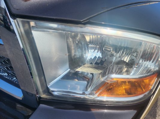

On the passenger side it seems there is a low beam and a high beam bulb. On the drivers side, it seems both the low and high beam function from the same bulb and there is not even a hole for a high beam bulb on the drivers side. Is this normal for the 2011 Laramie?

Can you post a picture of the front of the truck showing both headlights?
I seen this years ago on a customers truck, it was built at the factory with two different headlights.
Yes, tomorrow I will get a daytime and night time picture. Yeah, it definitely wasn't done while we had it and it was brand new when we purchased it

Not sure if you can see, but if you enlarge the night pictures, passenger side looks like a high been buld not lit, drivers side looks like a light lights the whole area. Meaning not dark like passenger side bottom

@LisaC yeap you have a DUAL on the driver's side and a QUAD on the passenger side.
When you turn the brights on, do both bulbs stay illuminated on the passenger side?
Good news it's easy to swap to either headlight, you just need the headlight assembly which can be found fairly inexpensive.
