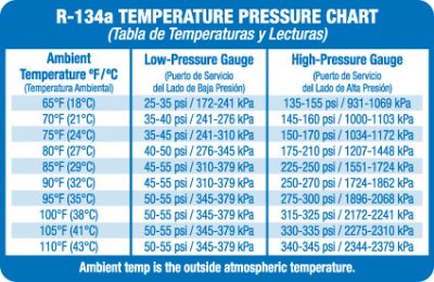

I've scoured the internet (and this forum). Perhaps the wildcard search isn't giving me the most accurate results. I'm wondering if anyone has a maintenance manual on a 2011 Ram 1500 5.7L (4th gen) in regards to the r134a pressures (suction/discharge).
I did a search and am unable to find anything. I'm guessing this question has come up at least a few times in the past. Does anyone have this information they would be willing to share? I'd certainly appreciate it if you could!

Get an a/c gauge and you can measure the pressure at the fill valve under the hood. It will yell you if you need any 134a. ftd

Standard R134a pressures. Just pressure wont tell you if it's low though, only way to know for sure is to have it discharged with an A/C machine to weigh the refrigerant.
