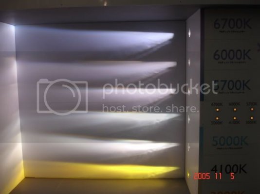

grabbed this off the internet. if it's accurate, i think 5000K looks ideal. of course you don't know how accurate the camera taking the picture is, etc.

yea 5000k is what i would want
