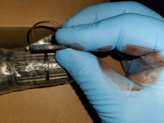

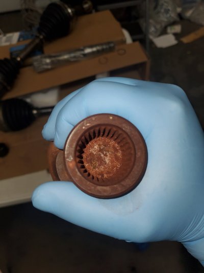

Here are the pictures of the splines inside the old CV.
Also picture of the clips the old clip the clip that I'm going to use to replace it. And the clip that comes on the new intermediary axle.
I dry fit the new CV axle onto the old axle splines without the clip in there and it feels rather secure same amount of play is probably the other side.
New on old splines
Looks like the new one is much tighter, I think you lucked out. Did you put any grease on the splines?
