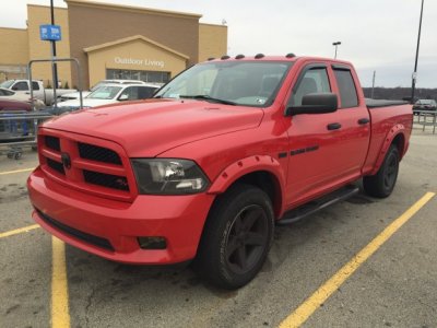

Update:
So, the weather was unbelievably warm today, so I went ahead and did my install. I got to be honest, it was a long day today. If you do this install yourself on a non-2500/3500, give yourself plenty of time to do it. If anyone wants step-by-step instructions on a 1500 to do cab lights on factory switch, I will be more than happy to help.
Here's a night shot of them. I'll upload some daytime shots in the morning.
Adam

As promised, a daytime photo.
Adam
