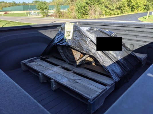

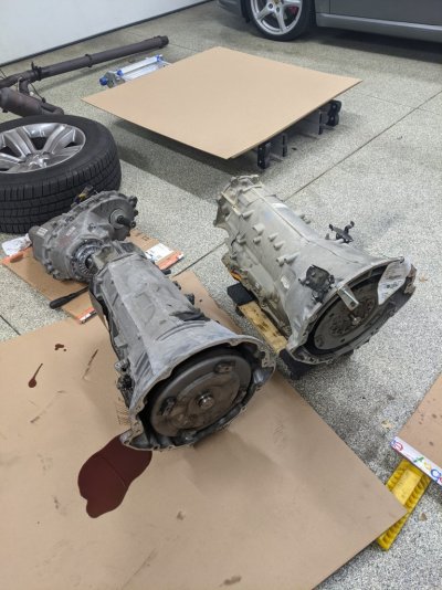

It's started...that 545RFE is a heavy...

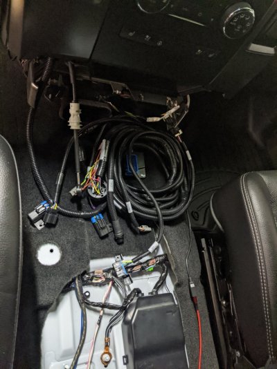

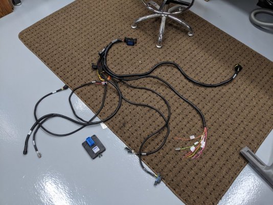

Got the SGA controller wired in (used the tow/haul plugs), and mounted it where the console will cover it and the extra unneeded wires as well.
I've plugged in the 8HP70 and SGA stuff (w/o retuning the truck yet), and verified I could pull the calibration file from the 8HP70; in an attempt to verify the used trans was 'good'. Also pulled the pan, nearly zero metal shavings in it...and will replace with a PPE pan when I install.
Yesterday was the removal; today is the install of the 8HP70. Took about 4 hours to remove everything, and I'm going to assume it will take slightly longer to install. I'd like to get it fired up today. Keep your fingers crossed for me!

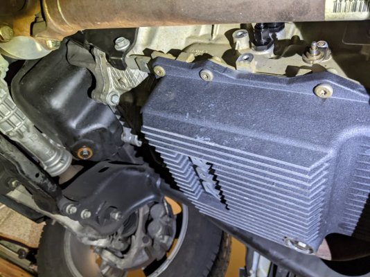

It's in! (sorry for late update).
I'll snap a few more pics later today / this week. There's not a whole lot to take pictures of!

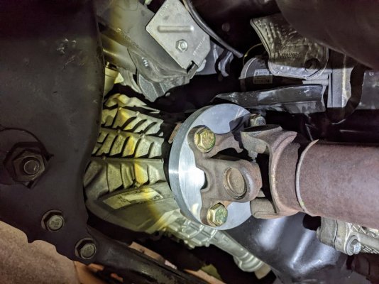

I got the front drive shaft spacer from superlift (P/N 66-04-4603), and was able to modify my OEM cross-member by slotting the holes to move the transmission mount 'back' about 1/2-in. It fits (but barely)!
I reused my 545RFE driveshaft. It fit fine, seems as if there is enough room in the tailshaft for the suspension travel; but it should probably be replaced with a 8-spd driveshaft or shortened by 3/4-in, just in case the rear bottoms out the load does not do through the transfer case and transmission as well.
I used a transmission from a 2016 Ram. Car transmissions need additional fabrication work for the lower dust cover. And since mine was a 4wd, car transmissions were out of the question anyhow. A truck transmission will require the cooler lines to be tapped, which takes all of about 10 mins.

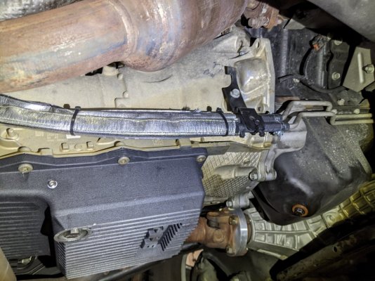

My truck was originally an Arizona market truck, and therefore did not have any factory transmission thermostat, as apparently some (most?) 545RFEs do. I did use an Improved Racing mini-thermostat at 145-deg F, which seems to be working well.
Shifts are very smooth, the many gear ranges available are night and day better than the 545RFE. Including the tuning, and the purchase of the HP Tuners box, I'm in it for $3,324.

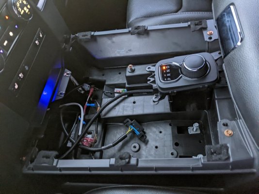

Here's some pics. Before I did this swap, I thought....'why are there so few pics of the swap?' Well, it's a general transmission R&R - not a ton to take pics of that is overly interesting!
I went with the dial shifter. Some complain about it; but a lever on an automatic doesn't make a manual - and if I feel the need to row through gears, I've got a 6-spd fun car to do so with. The shifter bezel is still a work in progress, it's about 90% complete, and now all the small details and surface imperfections need attention. So, it is a lot of fill, sand, prime, fill, sand, prime, until the surface is smooth as it should be.

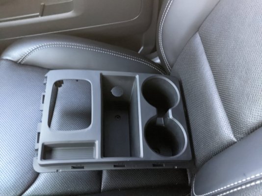

Couple of questions if you don't mind...which tcase do you have? Just wondering if the 44-44 will bolt right up, or if I'll have to go 44-45 (have heard conflicting things).
And what is that center console from that's laid on your front seat in one of your pics? I'm assuming it's your stock one that you cut out where the original shifter was? If so, nice job. I'm planning on going the Charger/Challenger shifter route, too bad the Durango shifter wouldn't work (that I know of) as I can get it cheapest on eBay.

The center console is exactly that - fantastic eye. I am still filling and priming it to get a perfect finish. It's not that it has really taken me two months to do, it's that I work on it maybe a day a week; as I don't want to spray paint in my basement due to the fumes (I have little kids and don't want them breathing it); so once a week I take it into work and use the lab there to paint it.
I bought both the dial shifter and a center console from a Durango; the console simply because I wanted the piece the dial shifter bolted to, which is what I grafted into / onto the stock shifter cover.
Will post pics when that is done, I am hoping next weekend!
