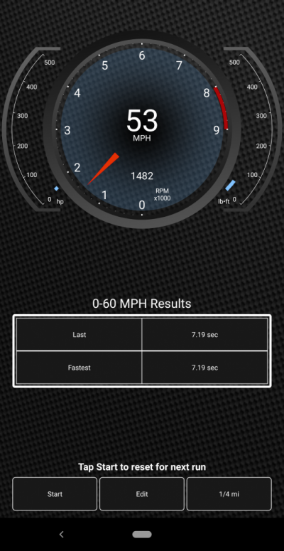

Did a 0-60 before the swap, nothing special, just mash the pedal (no power braking) and keep it mashed until 60mph. There was very little wheel spin. 0-60 time was 7.19-seconds.

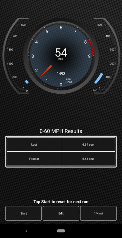

Finally got around to doing a repeat of the test, same method, same road, etc. Just mash the pedal (no power braking) and keep it mashed. This time, there was significant wheel spin, briefly saw the traction control light blink, but I didn't catch how long it took. Regardless, 0-60 time was 6.64-seconds.
This means (at minimum) I dropped 0.55-seconds from 0-60. I say at minimum because there was a lot of wheel spin with the 8HP70; which means with some finesse in the launch, I think I could bring this time down slightly.
That is a hell'va improvement from just a transmission swap. Old school rule of thumb is every tenth of a second is roughly a length,so on a 0 to 60 run,you've gained a little over 5 lengths,from the swap

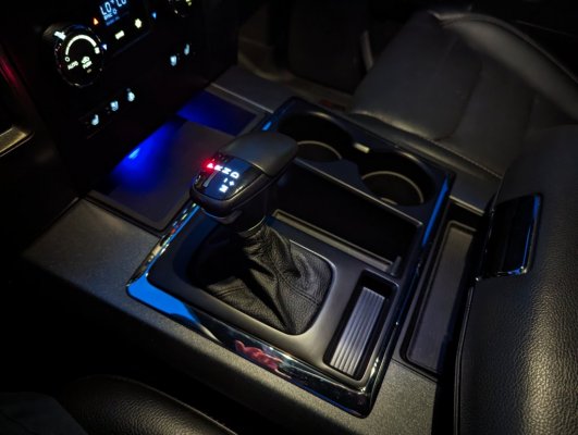

Decided I wanted the challenger shifter .... mainly because I want to be able to manually shift (really limit the highest gear)... so I installed the t-handle shifter.
Will need to send the TCM to Russel to flash different firmware in the summer; but until then, the shifter works for automatic shifting.
You guys will have to tell me which of the two shifters look better!

The shift lever is way better! Ram should have come that way stock! What year is the lever from? What's the earliest year I can use?
