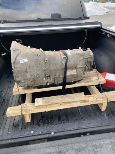

Otw to pick up a trans from a 2015 with only 22k kms for $800, hopefully isn't too good to be true. Debating getting the 1 year warranty for an extra $200.
With me being lifted I already have the driveshaft spacer, will I need an even bigger one? I'm assuming so.
And with me being regular cab would I still get away with using the stock driveshaft?

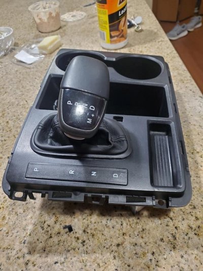

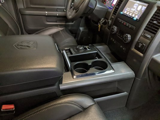

Teaser pic of the shifter. Need to support the shifter side (this weekend) and then reinstall the trim. I'm happy with it.

It's like drywall. I can make a nice smooth wall. It just takes me 5x longer than someone who knows what they're doing...and 10x more mud.

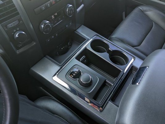

This is how I plan to do the shifter, pic is from one of the guys on the FB groups

What Shifter is that ? Id rather do that instead of all that fiberglass work.
smoothee
Jun 6, 2012
1,334
703
St. John's, NL
That's from a Challenger, but Charger is the same I'm pretty sure.
Just need to cutout the section from the Charger/Challenger trim and carry it over to the stock console. Is yours column shift or console?
And cutout a piece of aluminum or something to mount the assembly and use a few spacers to get proper clearance

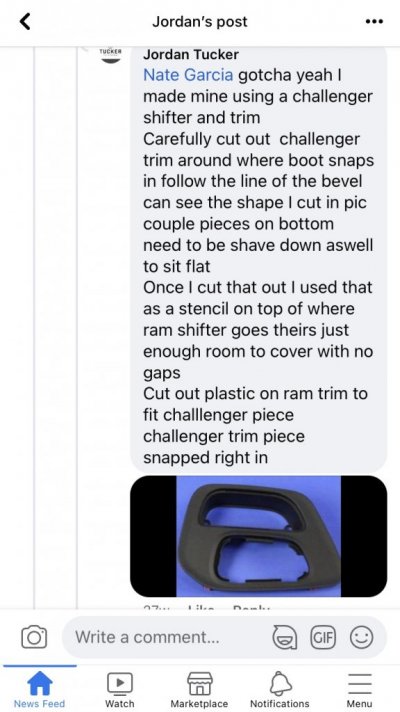

I think he did some glassing /sanding etc.,to get it to fit as nice as he did Ian.I forget who did it,but he had pics of it on facebook,either High Performance Rams or Tuned Rams.Somebody else used the Jeep shifter in their 8 speed swap,so there's a couple differant shifter options
I think it was Jordan Tucker, not sure if he's on here. As far as I remember he just cut out the piece from the Challenger and it snapped right in place to the section he cut out in the Ram console. Would need a steady hand though to make it a tidy job no doubt, but I think there are also stick on covers you can pick up on eBay/Amazon to cover that section
