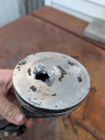

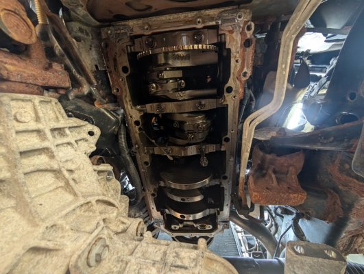

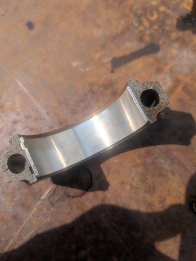

This will probably turn into a bit of a rebuild thread.
I finally got around to working on this 2012 5.7 ram with 100k that I bought off a customer. It initially came in locked up it happened at a idle the guy didnt want to install a new engine so I bought it and its sat for months until now. I started tearing into it today finally and this is what I found... cylinder 6... dropped a valve havent come across this before on a hemi.. I am hoping I can save the cylinder wall with a light hone I already have a new cylinder head from another build that i did not use. If I cant save this engine thinking about finally doing a 6.4 Swap or building the engine idk.. I only paid $1000 for this truck plenty of room open to ideas!.

View attachment 569362View attachment 569363View attachment 569364
Hope it didn't drop because of an overheated engine.
Unusual for a 4th gen to drop.
That was an issue with the 3rd gen.
I assume it broke the spring and they kept running it til it dropped. I dont really see any signs of a overheat thsu far oil is clean and coolant was full.

Dang. Hopefully the cylinder walls are ok but I'm guessing not with that piston damage image.
The rest are good no damage at all I plan on pulling the drivers side cylinder head tomorrow the one with the damage il be able to see the full extent cant see **** with the borescope ahaha.

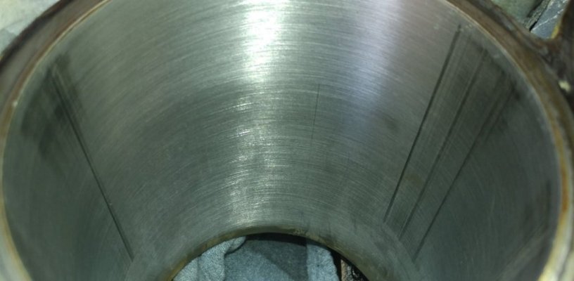

This is the cylinder with the dropped valve It looks way worse then is on camera its for the most part smooth and on the surface just waiting on a new honing tool I did this in the truck by the way just dropped the pan and knocked out the piston.

Also does anyone know where i can get A piston ? I dont really want to buy a whole set looks like most places only sell them as a set I would hate to put in a used one but I will if i have to being I need this truck now.
Jan 17, 2016
23,732
54,509
14 Sport
Check with your local hi-po dodge shops,ones that do drop in pistons /rods etc,odds are they'll have some low milege stock pistons/rods laying around ,from doing a drop in set.
