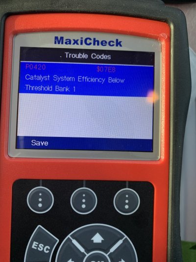

No present code but a pending code of P0420 which I don’t think would be related. The booster hose was reused and seemed to be in good condition. It hasn’t happened with aggressive braking- just like slowing down to a stoplight with my mom in the truck8F03B6A4-E612-4E9D-A7F6-7CECC392D900.jpeg

The https://www.obd-codes.com/p0420
is not likely your stalling problem
Read about it anyway

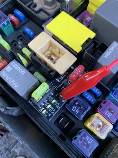

UPDATE:
Along with experiencing the above problems I began having severe battery drainage. Swapped out my Optima Yellow Top twice due to voltage being too low for my charger to even recognize the battery.
THE FIX!
Fuel pump relay malfunctioning. Pump was staying on even with the key out of the ignition. Found this through tons of troubleshooting and stumbled upon this YouTube Video:
I bought the TIPM Plug-In Relay System (Lite) and installed it on Saturday. Their website states all the other problems I was experiencing due to a faulty relay. No problems since and I haven’t connected it to the battery charger since installation.
Took more time to unpackage than the actual installation. Hope this helps some of you!
