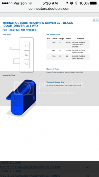

Good evening guys, I recently purchased a 2012 Ram Sport with the puddle lights/turn signals on the mirrors. The passenger side works just fine, but the driver side does not; the turn signal works fine but the puddle light potion does not work. I was able to remove the glass and get the light assembly out. When I unplugged it from the harness, there was so corrosion inside that two of the three make pins broke off inside the harness connector. I purchased a new light assembly but am unable to install it since the connector is messed up. So all that being said, 1) how can I remove the old pins from the highly corroded connector? And 2) is there any way I could just buy a new pigtail and wire it in myself? Thanks for any help you guys can offer.

This is the one I need; of course it's unavailable. Looks like I'll be searching through some junk yards!

So a little update. By some crazy luck I was able to find an entire driver side mirror harness on that auction site and bought it. I ordered a new puddle light assembly from chrysler and cut and spliced the new connector onto my harness. Now I have two working puddle lights. :waytogo:
