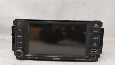

Ok, I found a factory touch screen radio on marketplace. 100 bucks. My aux went out and so local radio is awful. I cant play my music from iTunes. I am trying to figure out if anyone has successfully unlocked one using eBay. I don't want to have to deal with the dealership as everything I am reading says if it wasn't from the original owner they wont give it to you. I can't pick it up until Tuesday or Wednesday, but I just wanted to have a game plan. Also is it just plug and play once you get the code? I found this one on eBay and the video showed it worked. First picture is of what I found. The second one is what I have now. It does have satellite radio if that makes any difference.

@OnSale One more question. So I can tell after watching a pretty good video that the radio is a RBZ. The problem I see is that I cant seem to find out what it came out of. Its odd. It says MIC on the left top button and all RBZ radios from 08-12 show it to have the second picture. I have looked across the board at makes and models.

That top one looks like it might be an aftermarket offering. All OEM Mygigs have the three letter code on the AUX panel, and I've never seen an OEM Mygig with a MIC button. Any 2009 1500 only and 2010 - 2012 1500-3500 are plug and play.
jaws is right, that is not an oem RBZ radio. Tons of company’s sell aftermarket replicas that are slightly different.

That would make sense @jawzs2. I spent about 2 hours yesterday trying to figure out what it was out of. Once I can get the model number I can go from there. I really think that I am going to pass on this one and try and locate one from LKQ or something I know will work. With it being an aftermarket unit, it will probably be hard to figure out if it works in my truck.
Yeah - I'd pass on that one also, an OEM one from LKQ would probably be safest. I've seen them advertised wrong on ebay numerous times.
