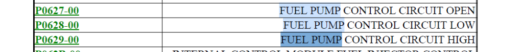

You sure about that code? I looked it up in the factory service manual for my 2013 Ram, and it doesn't exist in the manual.
It shows several others for the fuel pump

Test fuel pressure, if the pressure falls most likely will, it is likely the valve in fuel pump which means new fuel pump. I'm not sure if the fuel pump loses communication would stop fuel pump from keeping that valve open and closed at right time. I thought it was gravity would close valve could be wrong thinking, maybe it is wire, this is what I don't know. If it is a wire that closes valve, then it can be a wire issue such as TIPM maybe ignition but probably not, or wire feeding fuel pump. With that code and those symptoms, it can be but a few things.
