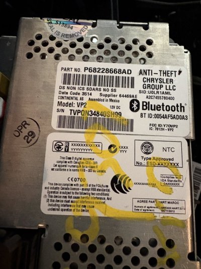

Hi, advice appreciated, did upgrade from RA1 to RA2 on my 2016 Tradesman, all works but Sirius gets stuck on Acquiring Signal, so I can’t tune to test channel or get any codes to give the Sirius people. Old radio had Sirius and it worked, so I know antennas good.
So I just compared my RA2 part number to the list at top of forum and mine ends in 668AD which isn’t on the list, did I get too new a radio, do I need newer antenna chip?
Radio doesn’t have the round production sticker so I don’t know when it was made.
Just odd and radio in great shape so I’d like to keep it.
Thsnks
Mike
Thsnks
Mike
Last 2 letters don't matter.
Just because the antenna could produce a strong enough signal with the old radio doesn't mean it will with the upgraded radio. Could also be an issue with the tuner in the replacement radio.
